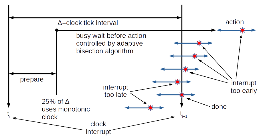

8.1.13. Interrupt Tests¶
In the operating system implementation you may have two kinds of critical sections. Firstly, there are low-level critical sections protected by interrupts disabled and maybe also some SMP spin lock. Secondly, there are high-level critical sections which are protected by disabled thread dispatching. The high-level critical sections may contain several low-level critical sections. Between these low-level critical sections interrupts may happen which could alter the code path taken in the high-level critical section.
The test framework provides support to write test cases for high-level critical sections though the T_interrupt_test() function:
typedef enum {
T_INTERRUPT_TEST_INITIAL,
T_INTERRUPT_TEST_ACTION,
T_INTERRUPT_TEST_BLOCKED,
T_INTERRUPT_TEST_CONTINUE,
T_INTERRUPT_TEST_DONE,
T_INTERRUPT_TEST_EARLY,
T_INTERRUPT_TEST_INTERRUPT,
T_INTERRUPT_TEST_LATE,
T_INTERRUPT_TEST_TIMEOUT
} T_interrupt_test_state;
typedef struct {
void (*prepare)(void *arg);
void (*action)(void *arg);
T_interrupt_test_state (*interrupt)(void *arg);
void (*blocked)(void *arg);
uint32_t max_iteration_count;
} T_interrupt_test_config;
T_interrupt_test_state T_interrupt_test(
const T_interrupt_test_config *config,
void *arg
This function returns T_INTERRUPT_TEST_DONE
if the test condition was
satisfied within the maximum iteration count, otherwise it returns
. The interrupt test run uses the specified
configuration and passes the specified argument to all configured handlers.
The function shall be called from thread context with interrupts enabled.
The interrupt test uses an adaptive bisection algorithm to try to hit the
code section under test by an interrupt. In each test iteration, it waits for
a time point one quarter of the clock tick interval after a clock tick using
the monotonic clock. Then it performs a busy wait using T_busy()
with a
busy count controlled by the adaptive bisection algorithm. The test maintains
a sample set of upper and lower bound busy wait count values. Initially, the
lower bound values are zero and the upper bound values are set to a value
returned by T_get_one_clock_tick_busy()
. The busy wait count for an
iteration is set to the middle point between the arithmetic mean of the lower
and upper bound sample values. After the action handler returns, the set of
lower and upper bound sample values is updated based on the test state. If the
test state is T_INTERRUPT_TEST_EARLY
, then the oldest upper bound sample
value is replaced by the busy wait count used to delay the action and the
latest lower bound sample value is slightly decreased. Reducing the lower
bound helps to avoid a zero length interval between the upper and lower bounds.
If the test state is T_INTERRUPT_TEST_LATE
, then the oldest lower bound
sample value is replaced by the busy wait count used to delay the action and
the latest upper bound sample value is slightly increased. In all other test
states the timing values remain as is. Using the arithmetic mean of a sample
set dampens the effect of each test iteration and is an heuristic to mitigate
the influence of jitters in the action code execution.
The optional prepare handler should prepare the system so that the action
handler can be called. It is called in a tight loop, so all the time consuming
setup should be done before T_interrupt_test()
is called. During the
preparation the test state is T_INTERRUPT_TEST_INITIAL
. The preparation
handler shall not change the test state.
The action handler should call the function which executes the code section under test. The execution path up to the code section under test should have a low jitter. Otherwise, the adaptive bisection algorithm may not find the right spot.
The interrupt handler should check if the test condition is satisfied or a
new iteration is necessary. This handler is called in interrupt context. It
shall return T_INTERRUPT_TEST_DONE
if the test condition is satisfied and
the test run is done. It shall return T_INTERRUPT_TEST_EARLY
if the
interrupt happened too early to satisfy the test condition. It shall return
if the interrupt happened too late to satisfy the
test condition. It shall return T_INTERRUPT_TEST_CONTINUE
if the test
should continue with the current timing settings. Other states shall not be
returned. It is critical to return the early and late states if the test
condition was not satisfied, otherwise the adaptive bisection algorithm may not
work. The returned state is used to try to change the test state from
to the returned state.
The optional blocked handler is invoked if the executing thread blocks during
the action processing. It should remove the blocking condition of the thread
so that the next iteration can start. It can use
T_interrupt_change_state()
to change the interrupt test state.
The max iteration count configuration member defines the maximum iteration
count of the test loop. If the maximum iteration count is reached before the
test condition is satisfied, then T_interrupt_test()
returns
The interrupt and blocked handlers may be called in arbitrary test states.
The action, interrupt, and blocked handlers can use
T_interrupt_test_get_state()
to get the current test state:
T_interrupt_test_state T_interrupt_test_get_state(void);
T_interrupt_test_change_state()
to try to change the test state from an
expected state to a desired state:
T_interrupt_test_state T_interrupt_test_change_state(
T_interrupt_test_state expected_state,
T_interrupt_test_state desired_state
The function returns the previous state. If it differs from the expected
state, then the requested state change to the desired state did not take
place. In an SMP configuration, do not call this function in a tight loop.
It could lock up the test run. To busy wait for a state change, use
The action handler can use T_interrupt_test_busy_wait_for_interrupt()
to
busy wait for the interrupt:
void T_interrupt_test_busy_wait_for_interrupt(void);
This is useful if the action code does not block to wait for the interrupt. If the action handler just returns the test code immediately prepares the next iteration and may miss an interrupt which happens too late.
