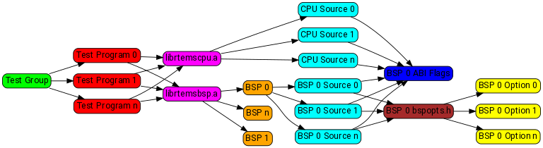

Fig. 10.1 Example with Explicit Item Links¶
This example shows how build item dependencies are specified explicitly
by item links. In this example, a user wants to build a group of tests.
Each test program has a dependency on the standard RTEMS libraries. The
first issue is that the librtemsbsp.a
needs dependencies to all base
BSP variants (more than 100). The dependencies are the values of the
links
attribute in the library item files. External BSPs would have
to modify the library item files. This is quite undesirable. The
second issue is that the source files of the librtemscpu.a
need a
dependency to the ABI compiler flags specified by each BSP. The third
issue is that each BSP has to define its own bspopts.h
configuration
header item.

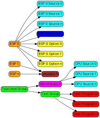

Fig. 10.2 Example with Implicit Ordering Rules¶
This example shows how build item dependencies are specified by dedicated
BSP items, a top-level group, and ordered item links. The BSP is
configured after the top-level group item and built before the top-level
group item (defined by wscript
source code). The library group is
configured and built before the test group as specified by the item link
order in the top-level group. The BSP options are processed before the
results are written to the configuration header bspopts.h
as defined by
the BSP item link order.

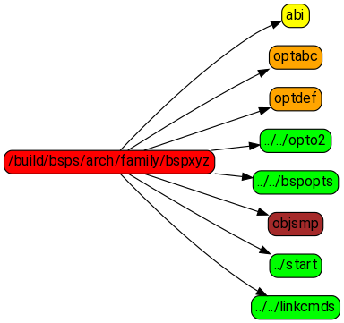

Fig. 10.3 This example shows a BSP family named family in the architecture arch
which consists of only one base BSP named xyz. The BSP sources and
installation information is contained in the
spec:/build/bsps/arch/family/bspxyz
BSP item. The items linked by the
BSP item are shown using relative UIDs.¶

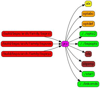

Fig. 10.4 This example shows a BSP family named family in the architecture arch
which consists of three base BSPs named rst, uvw, and xyz. The BSP
sources and installation information is contained in the obj objects
item. The group grp defines the main BSP constituents. The base BSP
items spec:/build/bsps/arch/family/bsprst
spec:/build/bsps/arch/family/bspuvw
, and
just define the name of the base
BSP and set a link to the group item. The base BSP and BSP family names
can be used for example in the default-by-variant
attribute of
Build Option Item Type items. The items linked by the BSP
items are shown using relative UIDs.¶
