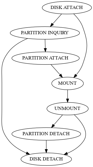

| enum rtems_media_event |
Disk life cycle events:

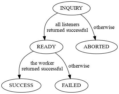

| enum rtems_media_state |
Normal state transition:
