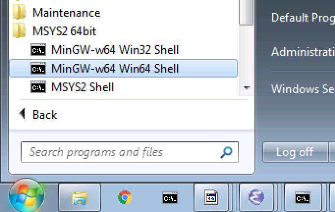

Open a 64bit MSYS shell from the Start Menu:
