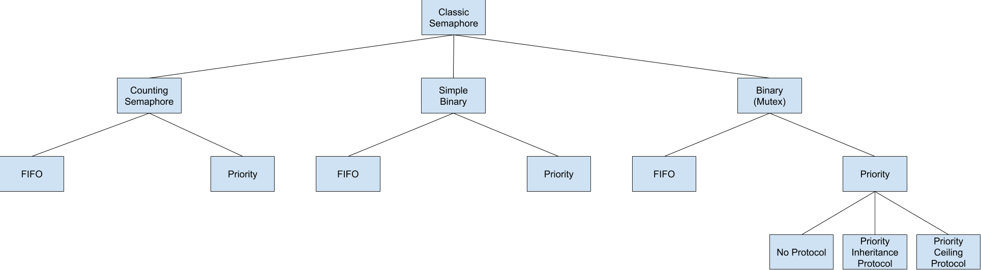

12.2.5. Building a Semaphore Attribute Set¶
In general, an attribute set is built by a bitwise OR of the desired attribute components. The following table lists the set of valid semaphore attributes:
tasks wait by FIFO (default) |
tasks wait by priority |
restrict values to 0 and 1 |
no restriction on values (default) |
restrict values to 0 and 1, do not allow nested access, allow deletion of locked semaphore. |
do not use priority inheritance (default) |
use priority inheritance |
do not use priority ceiling (default) |
use priority ceiling |
do not use Multiprocessor Resource Sharing Protocol (default) |
use Multiprocessor Resource Sharing Protocol |
local semaphore (default) |
global semaphore |
Attribute values are specifically designed to be mutually exclusive, therefore
bitwise OR and addition operations are equivalent as long as each attribute
appears exactly once in the component list. An attribute listed as a default
is not required to appear in the attribute list, although it is a good
programming practice to specify default attributes. If all defaults are
desired, the attribute RTEMS_DEFAULT_ATTRIBUTES
should be specified on this
call.
This example demonstrates the attribute_set parameter needed to create a local
semaphore with the task priority waiting queue discipline. The attribute_set
parameter passed to the rtems_semaphore_create
directive could be either
RTEMS_PRIORITY
or RTEMS_LOCAL | RTEMS_PRIORITY
. The attribute_set
parameter can be set to RTEMS_PRIORITY
because RTEMS_LOCAL
is the
default for all created tasks. If a similar semaphore were to be known
globally, then the attribute_set parameter would be RTEMS_GLOBAL |
RTEMS_PRIORITY
Some combinatinos of these attributes are invalid. For example, priority ordered blocking discipline must be applied to a binary semaphore in order to use either the priority inheritance or priority ceiling functionality. The following tree figure illustrates the valid combinations.
