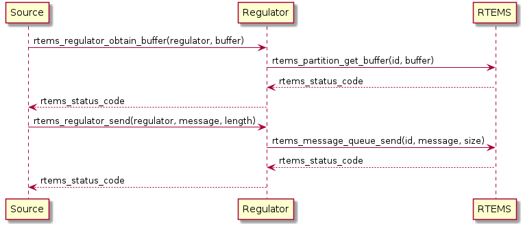

The sequence diagram below shows the interaction between a message Source, a Regulator instance, and RTEMS, given the usage described in the above paragraphs.
As illustrated in the preceding sequence diagram, the Source usually corresponds to application software reading a system input. The Source obtains a buffer from the Regulator instance and fills it with incoming data. The application explicitly obtaining a buffer and filling it in allows for zero copy operations on the Source side.
After the Source has sent the message to the Regulator instance, the Source is free to process another input and the Regulator instance will ensure that the buffer is delivered to the Delivery function and Destination.
