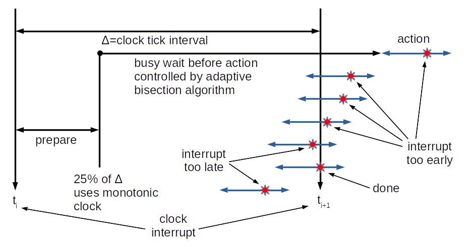

You can busy wait with the T_busy() function:
void T_busy(uint_fast32_t count);
It performs a busy loop with the specified iteration count. This function is optimized to not perform memory accesses and should have a small jitter. The loop iterations have a processor-specific duration.
You can get an iteration count for the T_busy() function which corresponds
roughly to one clock tick interval with the T_get_one_clock_tick_busy()
function:
uint_fast32_t T_get_one_clock_tick_busy(void);
This function requires a clock driver. It must be called from thread context with interrupts enabled. It may return a different value each time it is called.

The interrupt test uses an adaptive bisection algorithm to try to hit the
code section under test by an interrupt. In each test iteration, it waits for
a time point one quarter of the clock tick interval after a clock tick using
the monotonic clock. Then it performs a busy wait using T_busy() with a
busy count controlled by the adaptive bisection algorithm. The test maintains
a sample set of upper and lower bound busy wait count values. Initially, the
lower bound values are zero and the upper bound values are set to a value
returned by T_get_one_clock_tick_busy(). The busy wait count for an
iteration is set to the middle point between the arithmetic mean of the lower
and upper bound sample values. After the action handler returns, the set of
lower and upper bound sample values is updated based on the test state. If the
test state is T_INTERRUPT_TEST_EARLY, then the oldest upper bound sample
value is replaced by the busy wait count used to delay the action and the
latest lower bound sample value is slightly decreased. Reducing the lower
bound helps to avoid a zero length interval between the upper and lower bounds.
If the test state is T_INTERRUPT_TEST_LATE, then the oldest lower bound
sample value is replaced by the busy wait count used to delay the action and
the latest upper bound sample value is slightly increased. In all other test
states the timing values remain as is. Using the arithmetic mean of a sample
set dampens the effect of each test iteration and is an heuristic to mitigate
the influence of jitters in the action code execution.
The optional prepare handler should prepare the system so that the action
handler can be called. It is called in a tight loop, so all the time consuming
setup should be done before T_interrupt_test() is called. During the
preparation the test state is T_INTERRUPT_TEST_INITIAL. The preparation
handler shall not change the test state.
The action handler should call the function which executes the code section under test. The execution path up to the code section under test should have a low jitter. Otherwise, the adaptive bisection algorithm may not find the right spot.
The interrupt handler should check if the test condition is satisfied or a
new iteration is necessary. This handler is called in interrupt context. It
shall return T_INTERRUPT_TEST_DONE if the test condition is satisfied and
the test run is done. It shall return T_INTERRUPT_TEST_EARLY if the
interrupt happened too early to satisfy the test condition. It shall return
T_INTERRUPT_TEST_LATE if the interrupt happened too late to satisfy the
test condition. It shall return T_INTERRUPT_TEST_CONTINUE if the test
should continue with the current timing settings. Other states shall not be
returned. It is critical to return the early and late states if the test
condition was not satisfied, otherwise the adaptive bisection algorithm may not
work. The returned state is used to try to change the test state from
T_INTERRUPT_TEST_ACTION to the returned state.
The optional blocked handler is invoked if the executing thread blocks during
the action processing. It should remove the blocking condition of the thread
so that the next iteration can start. It can use
T_interrupt_change_state() to change the interrupt test state.
The max iteration count configuration member defines the maximum iteration
count of the test loop. If the maximum iteration count is reached before the
test condition is satisfied, then T_interrupt_test() returns
T_INTERRUPT_TEST_TIMEOUT.
