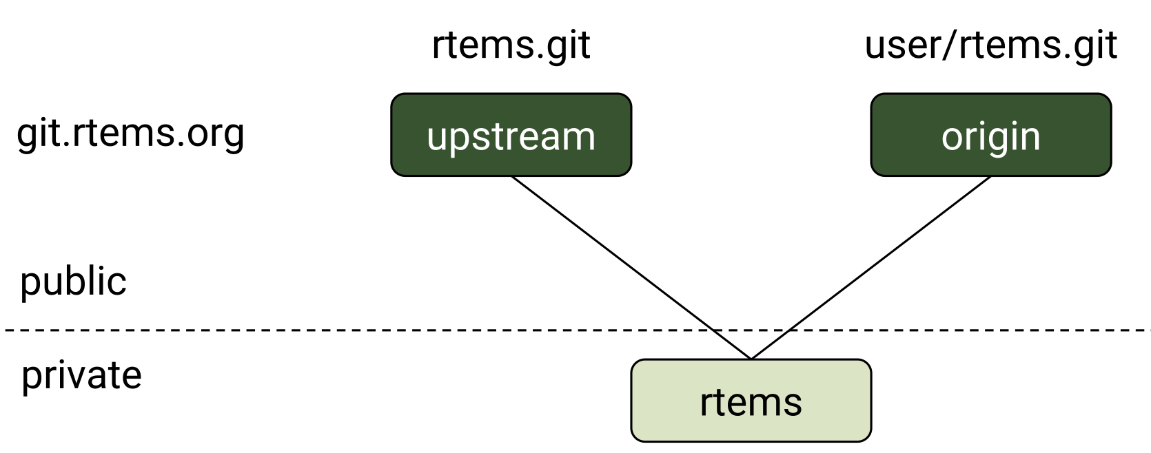

Personal repositories keep the clutter away from the upstream repository. A user with a personal repository can make commits, create and delete branches, plus more without interfering with the upstream repository. Commits to the upstream repository generate email to the vc@ list and development type commits by a developer would only add noise and lessen the effectiveness of the commit list
A committer should maintain a personal clone of the RTEMS repository through which all changes merged into the RTEMS head are sent. The personal repository is also a good place for committers to push branches that contain works in progress. The following instructions show how to setup a personal repositor that by default causes commits to go to your private local repository and pushes to go to your publicly visible personal repository. The RTEMS head is configured as a remote repository named ‘upstream’ to which you can push changes that have been approved for merging into RTEMS.
Branches aren’t automatically pushed until you tell git to do the initial push after which the branch is pushed automatically. In order to keep code private just put it on a branch in your local clone and do not push the branch.

Add the RTEMS repository as a remote repository and get the remote tags and branches
# git remote add upstream ssh://user@dispatch.rtems.org/data/git/rtems.git
# git fetch upstream
After a little while you should be able to see your personal repo at https://git.rtems.org/@USER@/rtems.git/ and you can create other repositories in your git directory that will propagate to https://git.rtems.org/@USER@/ if you need. For example, joel’s personal repos appear at https://git.rtems.org/joel/.
