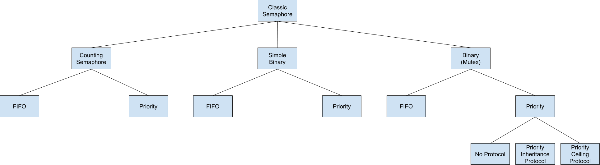

12.2.5. Building a Semaphore Attribute Set
In general, an attribute set is built by a bitwise OR of the desired attribute components. The following table lists the set of valid semaphore attributes:
RTEMS_FIFO
tasks wait by FIFO (default)
RTEMS_PRIORITY
tasks wait by priority
RTEMS_BINARY_SEMAPHORE
restrict values to 0 and 1
RTEMS_COUNTING_SEMAPHORE
no restriction on values (default)
RTEMS_SIMPLE_BINARY_SEMAPHORE
restrict values to 0 and 1, do not allow nested access, allow deletion of locked semaphore.
RTEMS_NO_INHERIT_PRIORITY
do not use priority inheritance (default)
RTEMS_INHERIT_PRIORITY
RTEMS_NO_PRIORITY_CEILING
do not use priority ceiling (default)
RTEMS_PRIORITY_CEILING
RTEMS_NO_MULTIPROCESSOR_RESOURCE_SHARING
do not use Multiprocessor Resource Sharing Protocol (default)
RTEMS_MULTIPROCESSOR_RESOURCE_SHARING
RTEMS_LOCAL
local semaphore (default)
RTEMS_GLOBAL
global semaphore
Attribute values are specifically designed to be mutually exclusive, therefore bitwise OR and addition operations are equivalent as long as each attribute appears exactly once in the component list. An attribute listed as a default is not required to appear in the attribute list, although it is a good programming practice to specify default attributes. If all defaults are desired, the attribute RTEMS_DEFAULT_ATTRIBUTES should be specified on this call.
This example demonstrates the attribute_set parameter needed to create a local semaphore with the task priority waiting queue discipline. The attribute_set parameter passed to the rtems_semaphore_create directive could be either RTEMS_PRIORITY or RTEMS_LOCAL | RTEMS_PRIORITY. The attribute_set parameter can be set to RTEMS_PRIORITY because RTEMS_LOCAL is the default for all created tasks. If a similar semaphore were to be known globally, then the attribute_set parameter would be RTEMS_GLOBAL | RTEMS_PRIORITY.
Some combinatinos of these attributes are invalid. For example, priority ordered blocking discipline must be applied to a binary semaphore in order to use either the priority inheritance or priority ceiling functionality. The following tree figure illustrates the valid combinations.
