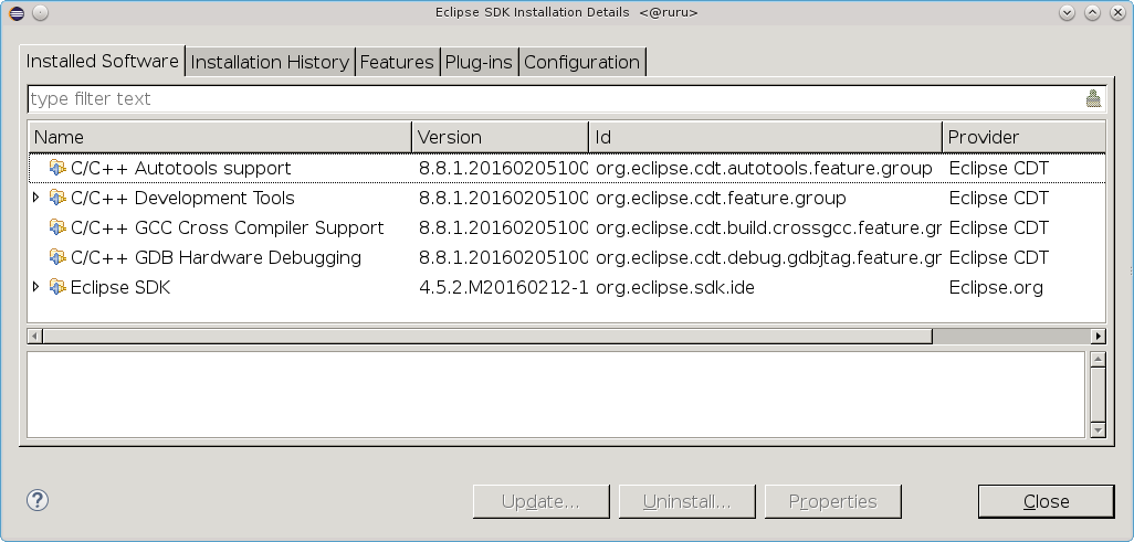

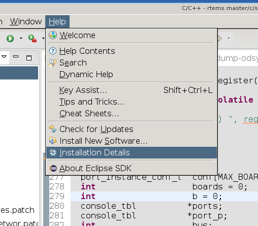

Start Eclipse and check to see if you have the them installed via the Help, Installation Details menu item:
The dialog box shows the installed software packages and you can see the C/C++ Autotools support and the C/C++ Development Tools are installed:
You can see some other software packages are installed in the figure. You can ignore those.

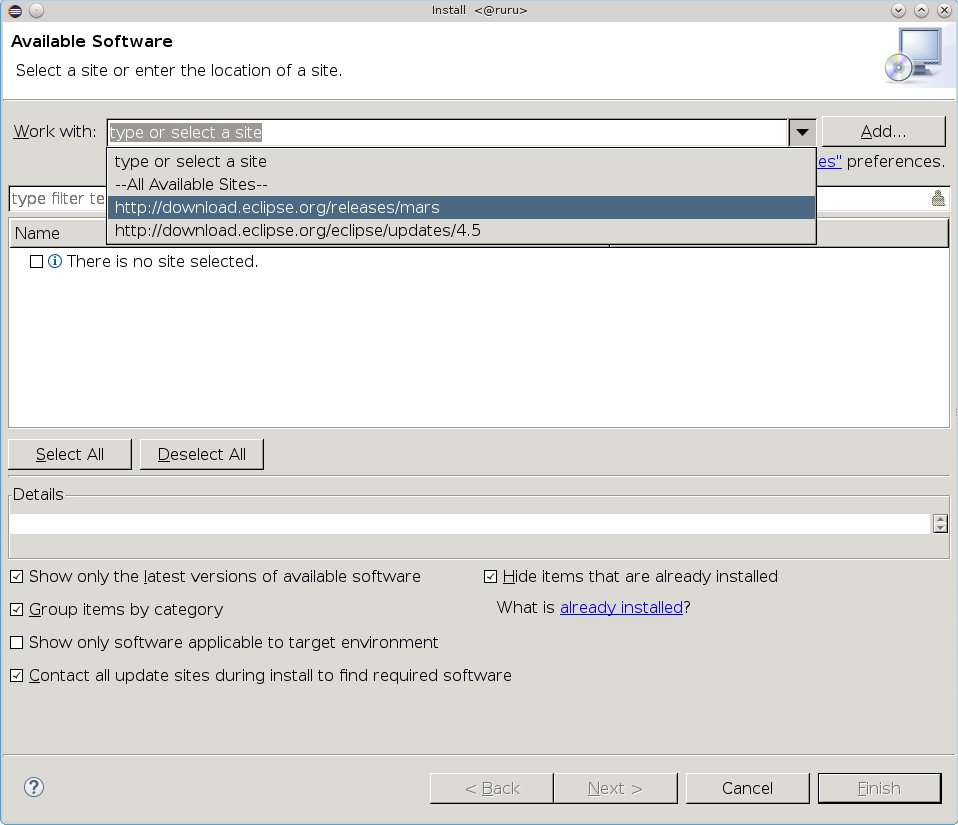

If you do not have the listed software packages install select Help, Install New Software and in the Work with: list box select http://download.eclipse.org/releases/mars.

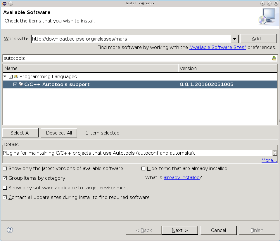

Afer a small period of time a list of available packages will populate and you
can select the ones we are interested in. Enter autotools
in the search
box and select the package:

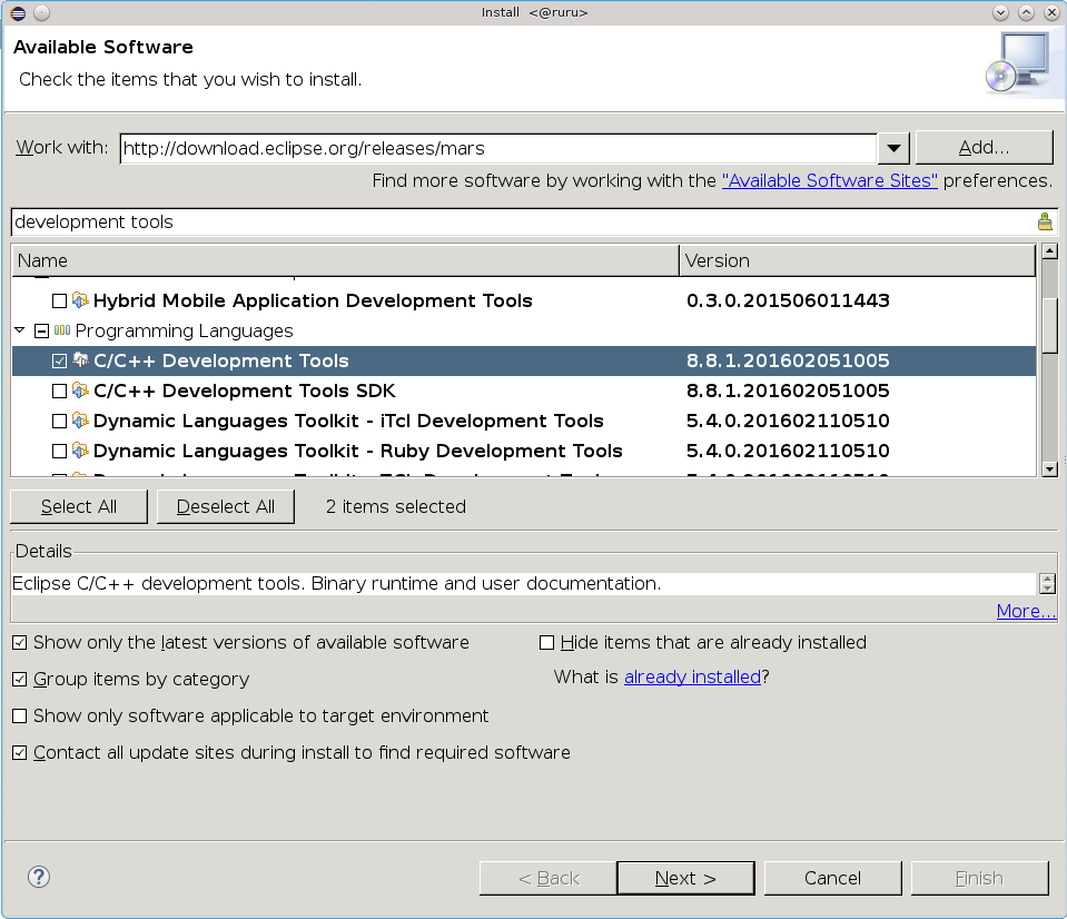

Clear the search line and enter development tools
in the search box and
then scroll down to find C/C++ Development Tools:

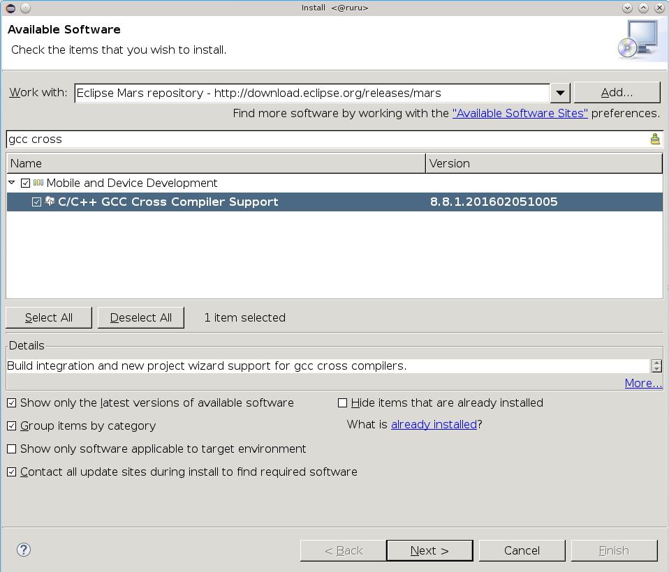

Again clear the search line and enter gcc cross
select the package:
Click Next and once the Install Details have determined what is needed select Finish to install the packages.

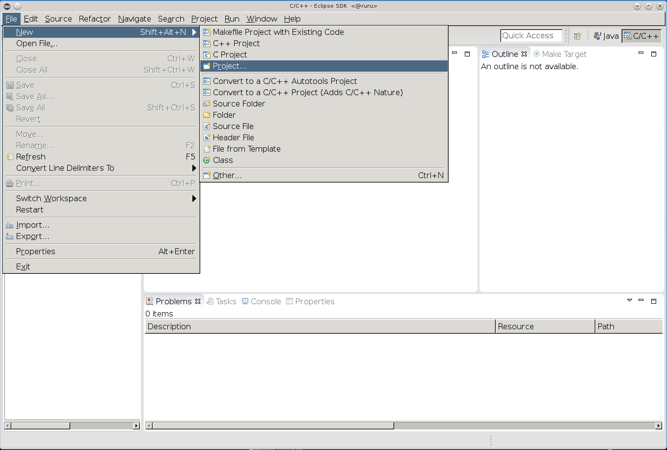

Select File, New, Project :

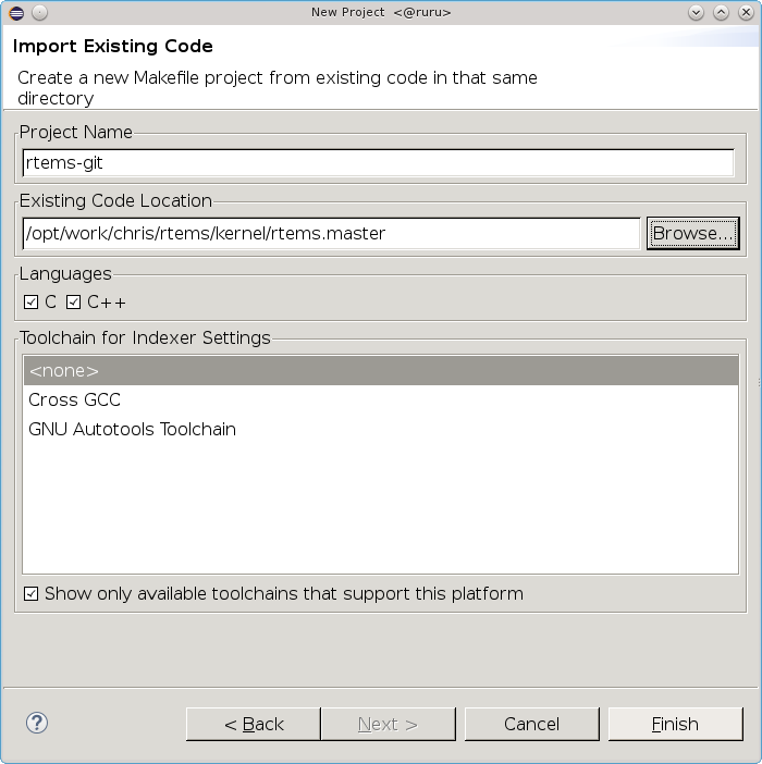

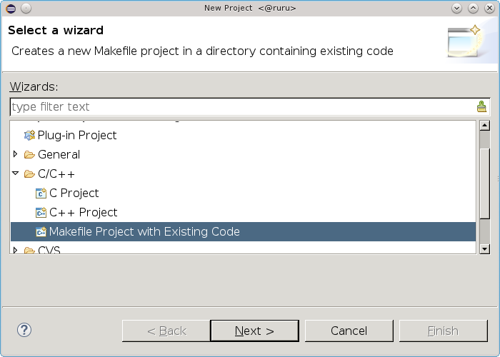

Click on C/C++ and select Makefile Project with Existing Code then select Next :
Enter the project name rtems-git
into the Project Name field and select
the Browse… button and the path to the RTEMS Kernel source code then
click Finish :

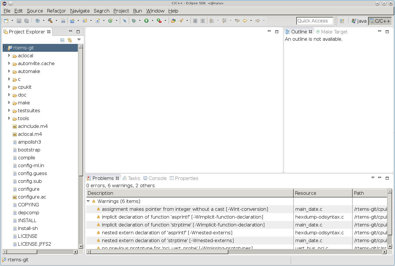

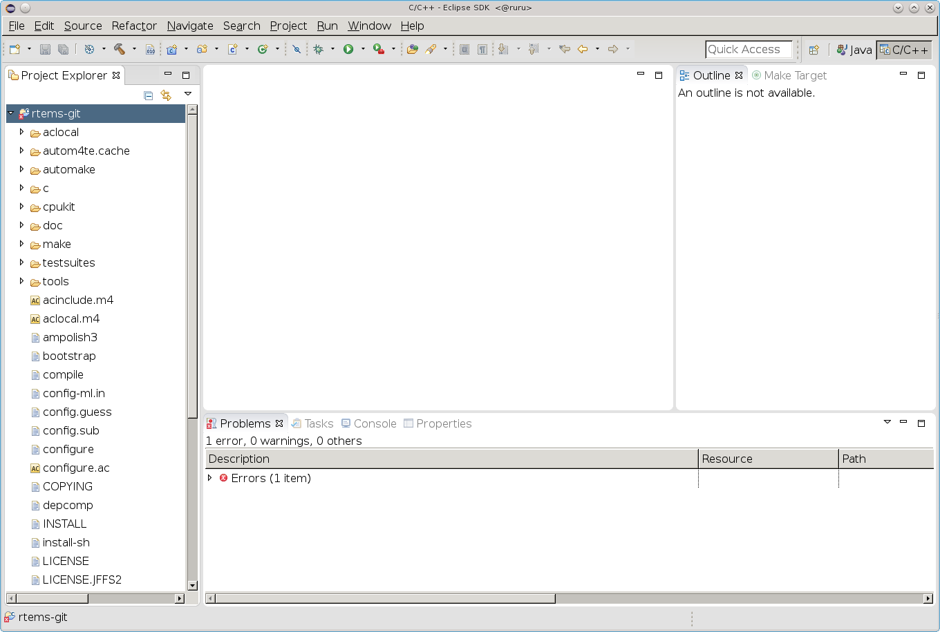

Eclipse will show the RTEMS Kernel source code in the Project Explorer panel:

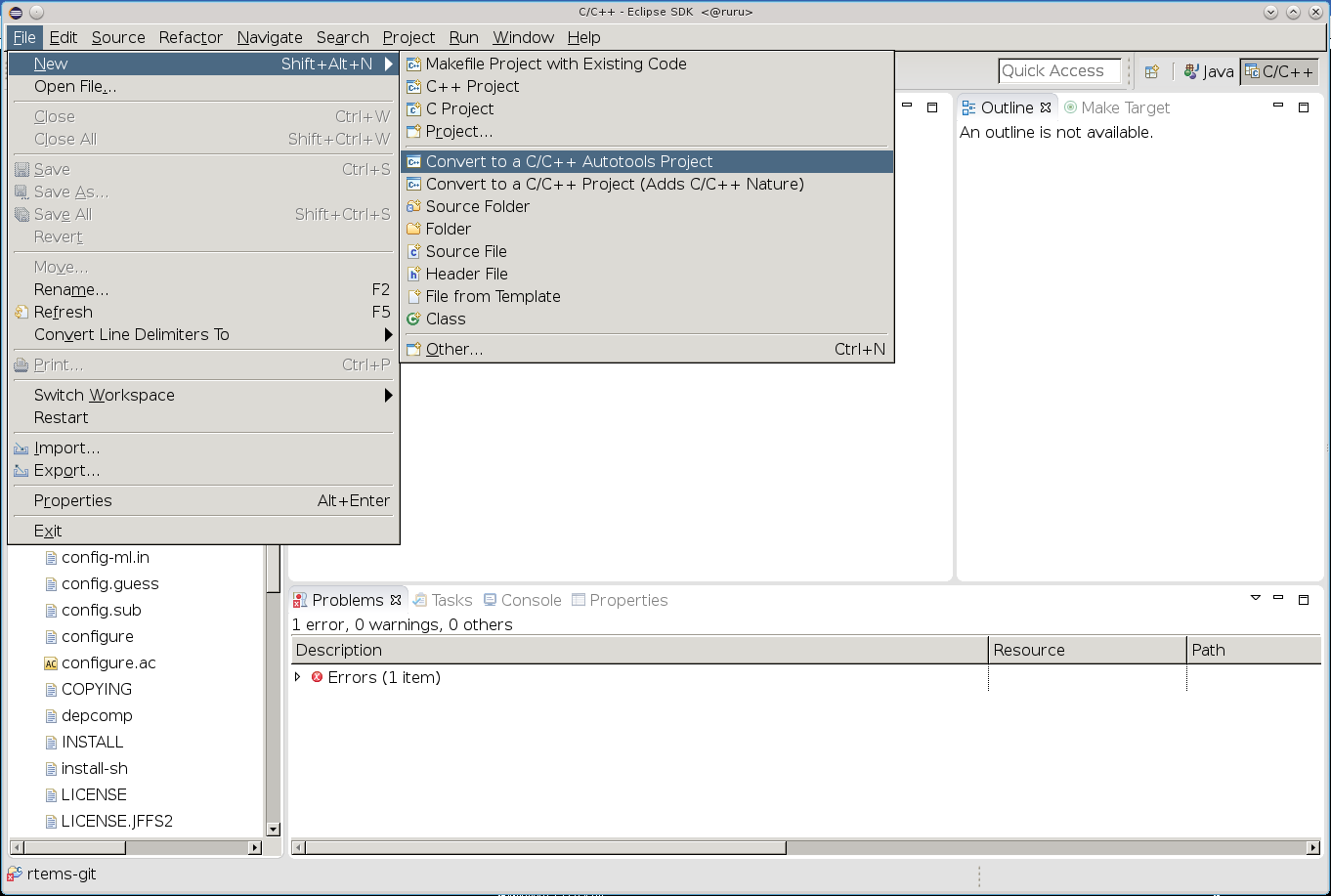

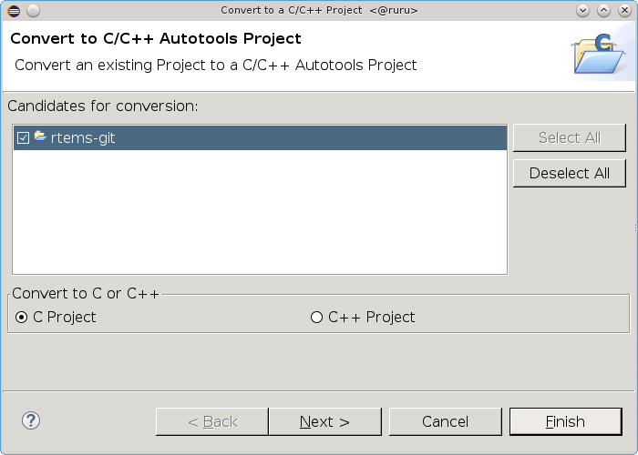

We now convert the project to an Autotools project. Select File, New, Convert to a C/C++ Autotools Project :
Select C Project then Finish :

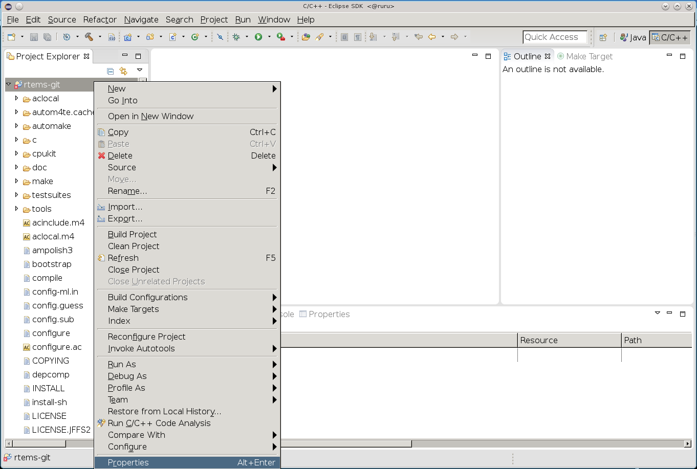

We now configure the project’s properties by right clicking on the
rtems-git
project title and then Properties :

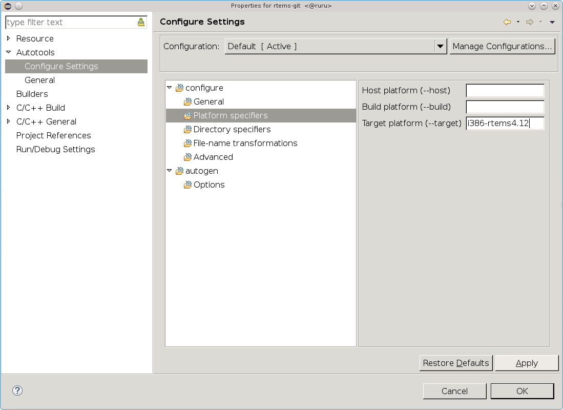

Click on the Autotools item then Configure Settings and Platform
specifiers and set the Target platform field with i386-rtems5

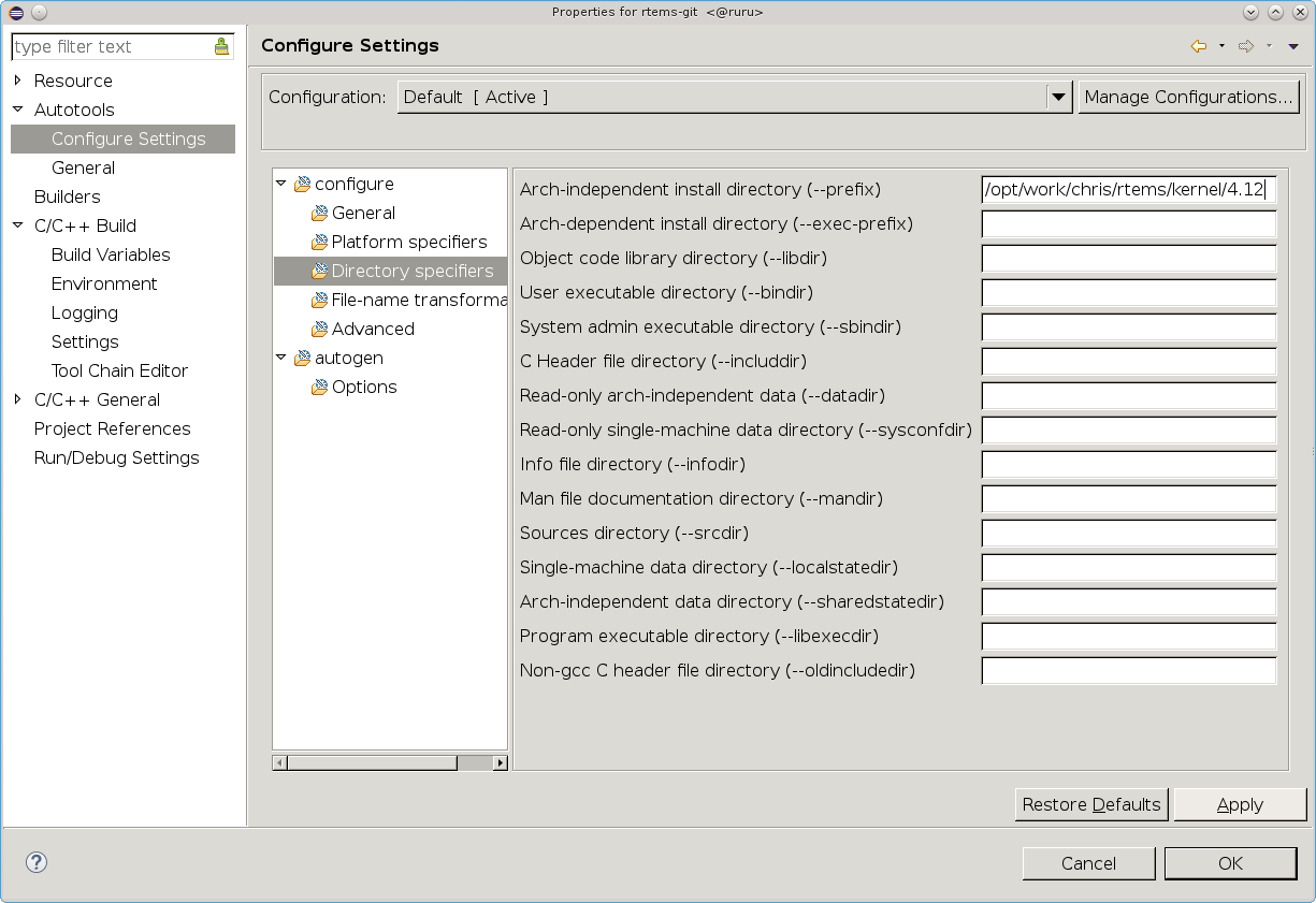

Select Platform directories and enter the Arch-independent install
directory (–prefix) to the RTEMS Kernel prefix of
/opt/work/chris/rtems/kernel/5

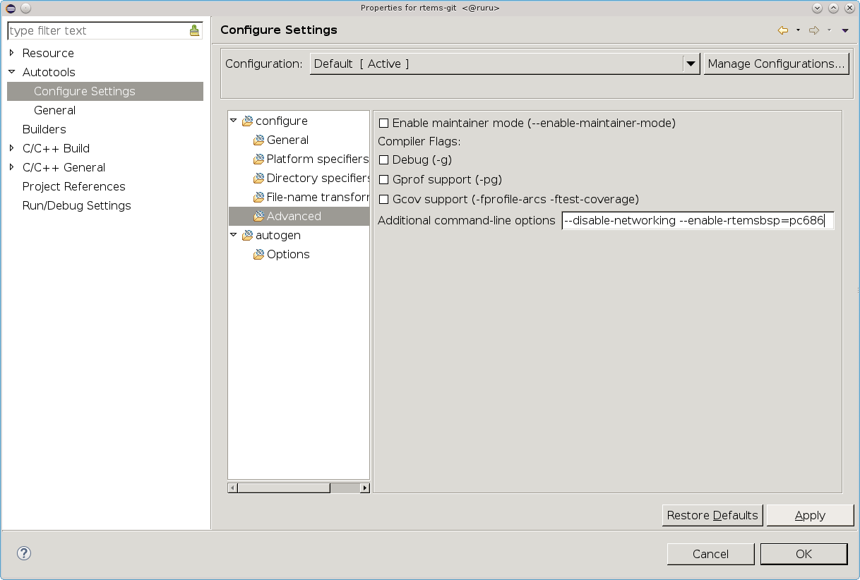

We disable networking to use the external LibBSD package and set the BSP to
pc686
. Select the Advanced and in the Additional command-line
options enter --disable-networking
and --enable-rtemsbsps=pc686
. You
can add extra options you may need:

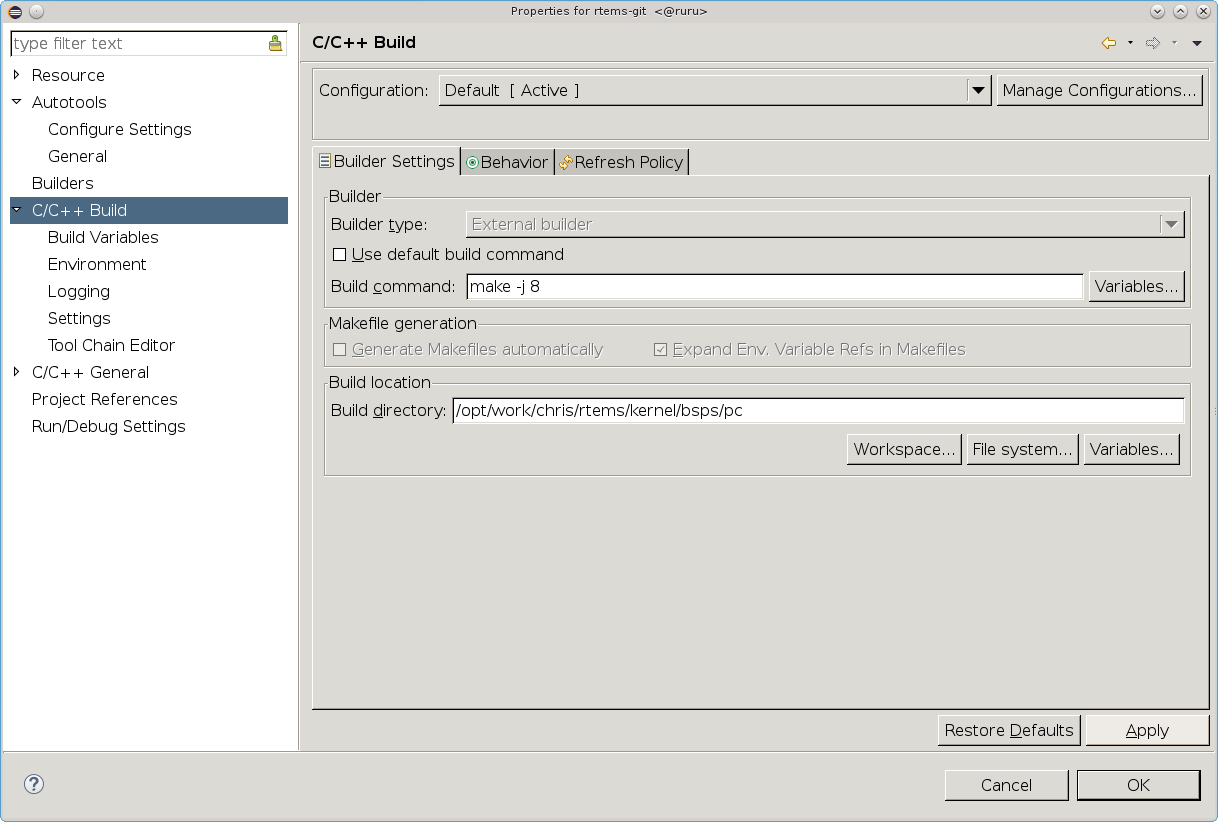

Select C/C++ Build and Environment. Uncheck or clear the Use default
build command and add -j N
where N
is the number of cores you have in
your machine. The figure has told make to run 8 jobs, one per core for an 8
core machine. Click on the File system… button and navigate to the BSP
build directory. This is the location Eclipse builds the BSP. RTEMS requires
you build outside the source tree and in this example we are forcing the build
directory to something specific. Finish by pressing Apply :

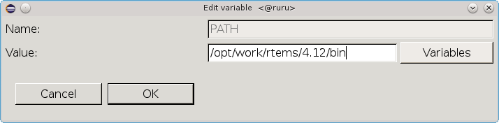

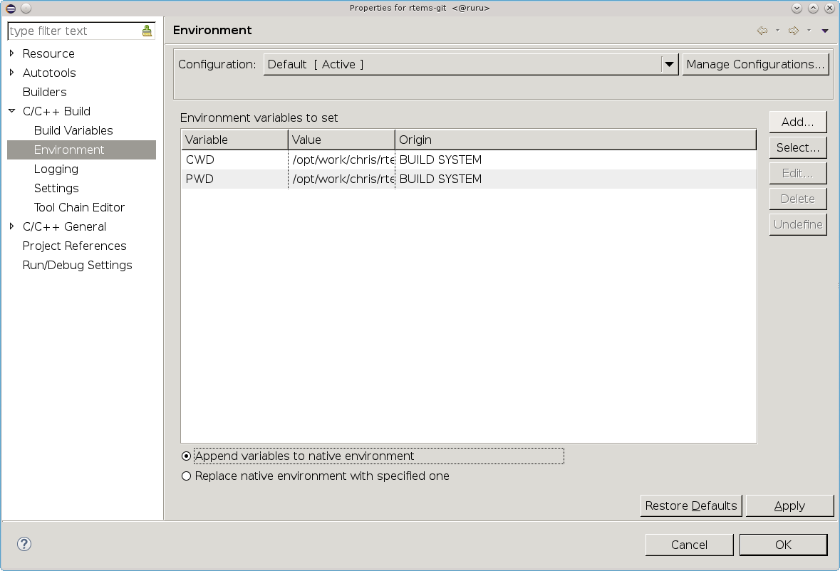

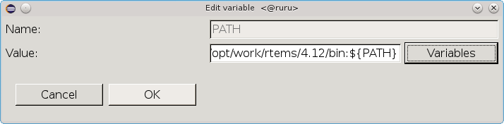

Select Environment under C/C++ Build as we need to set the path to the RTEMS Tools. In this example we set the path in the Eclipse project so each project can have a specific set of tools. Press the Add… button:
Enter the path to the tools, in our case it is
/opt/work/rtems/5/bin

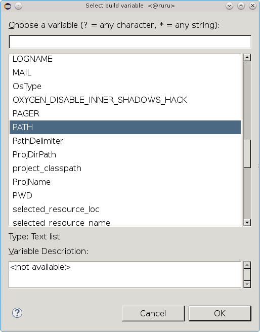

, then press Variables :

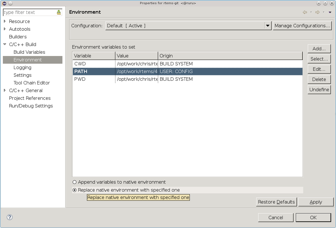

Scroll down and select PATH and then press OK :
You will now see the path in the Value: field. Make sure you have a path separator between the end of the tools path and the path variable we have just added. In this case is a Unix host and the separator is :. Windows use ;. Press OK when you have a valid path:
The Environment panel will now show the added PATH variable. Click Replace native environment with specified one as shown and then press Apply :

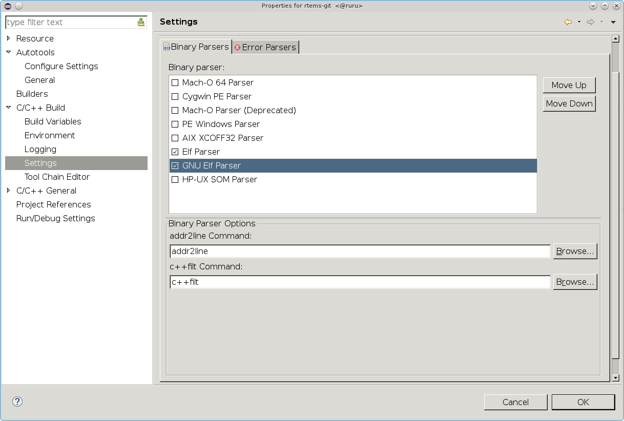

Select Settings under C/C++ Build and check Elf Parser and GNU Elf Parser and then press OK :

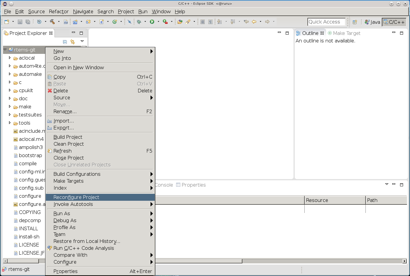

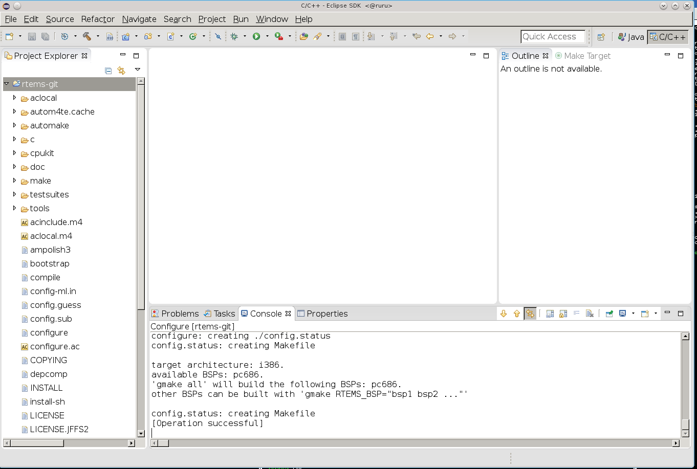

We are now ready to run configure using Eclipse. Right click on the project
name rtems-git
and then Reconfigure Project :
Select the Console tab in the output panel to view the configure process
output. You will notice the end of the configure process shows the names of the
BSPs we have asked to build. In our case this is the pc686
BSP:

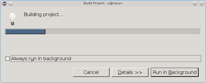

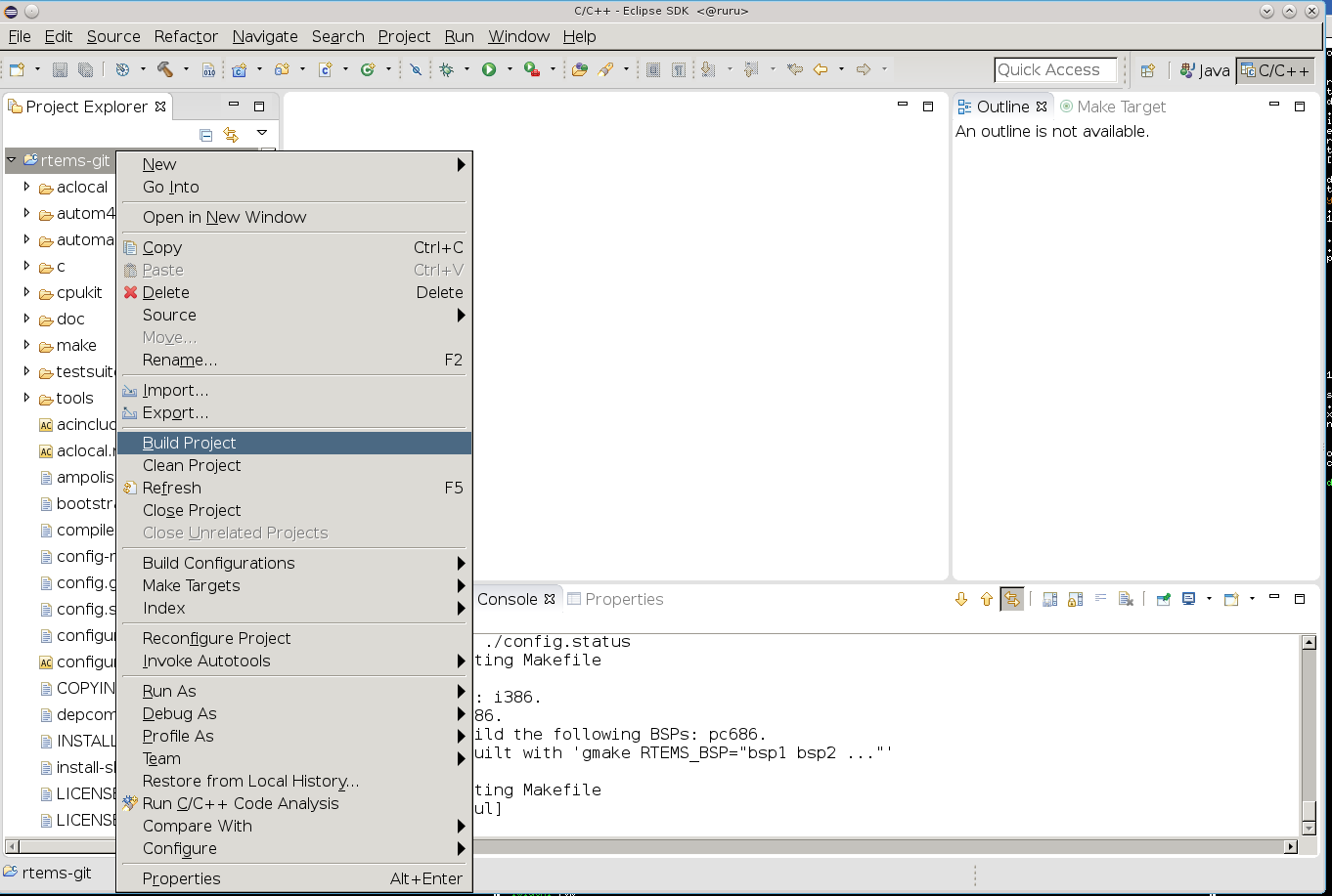

We can now build RTEMS using Eclipse. Right click on the project name
rtems-git
and then select Build Project :
A Build Project message box will appear showing the progress:
When finished click on the Problems output tab to view any errors or warnings:
