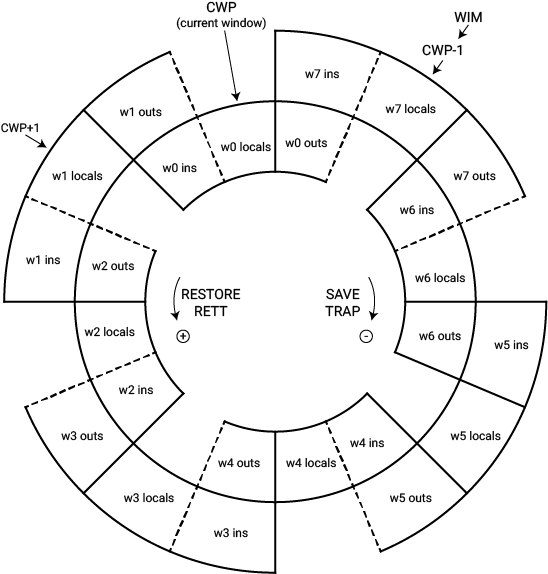

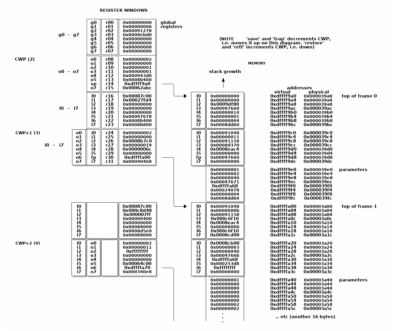

18.2.2. Register Windows¶
The SPARC architecture includes the concept of register windows. An overly simplistic way to think of these windows is to imagine them as being an infinite supply of “fresh” register sets available for each subroutine to use. In reality, they are much more complicated.
The save instruction is used to obtain a new register window. This instruction decrements the current window pointer, thus providing a new set of registers for use. This register set includes eight fresh local registers for use exclusively by this subroutine. When done with a register set, the restore instruction increments the current window pointer and the previous register set is once again available.
The two primary issues complicating the use of register windows are that (1) the set of register windows is finite, and (2) some registers are shared between adjacent registers windows.
Because the set of register windows is finite, it is possible to execute enough save instructions without corresponding restore’s to consume all of the register windows. This is easily accomplished in a high level language because each subroutine typically performs a save instruction upon entry. Thus having a subroutine call depth greater than the number of register windows will result in a window overflow condition. The window overflow condition generates a trap which must be handled in software. The window overflow trap handler is responsible for saving the contents of the oldest register window on the program stack.
Similarly, the subroutines will eventually complete and begin to perform restore’s. If the restore results in the need for a register window which has previously been written to memory as part of an overflow, then a window underflow condition results. Just like the window overflow, the window underflow condition must be handled in software by a trap handler. The window underflow trap handler is responsible for reloading the contents of the register window requested by the restore instruction from the program stack.
The Window Invalid Mask (wim) and the Current Window Pointer (cwp) field in the psr are used in conjunction to manage the finite set of register windows and detect the window overflow and underflow conditions. The cwp contains the index of the register window currently in use. The save instruction decrements the cwp modulo the number of register windows. Similarly, the restore instruction increments the cwp modulo the number of register windows. Each bit in the wim represents represents whether a register window contains valid information. The value of 0 indicates the register window is valid and 1 indicates it is invalid. When a save instruction causes the cwp to point to a register window which is marked as invalid, a window overflow condition results. Conversely, the restore instruction may result in a window underflow condition.
Other than the assumption that a register window is always available for trap (i.e. interrupt) handlers, the SPARC architecture places no limits on the number of register windows simultaneously marked as invalid (i.e. number of bits set in the wim). However, RTEMS assumes that only one register window is marked invalid at a time (i.e. only one bit set in the wim). This makes the maximum possible number of register windows available to the user while still meeting the requirement that window overflow and underflow conditions can be detected.
The window overflow and window underflow trap handlers are a critical part of the run-time environment for a SPARC application. The SPARC architectural specification allows for the number of register windows to be any power of two less than or equal to 32. The most common choice for SPARC implementations appears to be 8 register windows. This results in the cwp ranging in value from 0 to 7 on most implementations.
The second complicating factor is the sharing of registers between adjacent register windows. While each register window has its own set of local registers, the input and output registers are shared between adjacent windows. The output registers for register window N are the same as the input registers for register window ((N - 1) modulo RW) where RW is the number of register windows. An alternative way to think of this is to remember how parameters are passed to a subroutine on the SPARC. The caller loads values into what are its output registers. Then after the callee executes a save instruction, those parameters are available in its input registers. This is a very efficient way to pass parameters as no data is actually moved by the save or restore instructions.

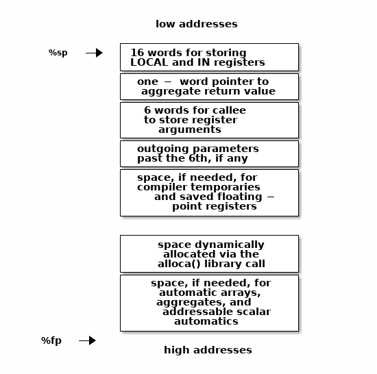

The SPARC architecture supports a simple yet effective call and return mechanism. A subroutine is invoked via the call (call) instruction. This instruction places the return address in the caller’s output register 7 (o7). After the callee executes a save instruction, this value is available in input register 7 (i7) until the corresponding restore instruction is executed.
The callee returns to the caller via a jmp to the return address. There is a delay slot following this instruction which is commonly used to execute a restore instruction - if a register window was allocated by this subroutine.
It is important to note that the SPARC subroutine call and return mechanism does not automatically save and restore any registers. This is accomplished via the save and restore instructions which manage the set of registers windows.
In case a floating-point unit is supported, then floating-point return values appear in the floating-point registers. Single-precision values occupy %f0; double-precision values occupy %f0 and %f1. Otherwise, these are scratch registers. Due to this the hardware and software floating-point ABIs are incompatible.
18.2.4. Calling Mechanism¶
All RTEMS directives are invoked using the regular SPARC calling convention via the call instruction.
18.2.5. Register Usage¶
As discussed above, the call instruction does not automatically save any registers. The save and restore instructions are used to allocate and deallocate register windows. When a register window is allocated, the new set of local registers are available for the exclusive use of the subroutine which allocated this register set.

The overlap of the registers is illustrated in figure 1. The figure
shows an implementation with 8 windows, numbered 0 to 7 (labeled w0 to
w7 in the figure). Each window corresponds to 24 registers, 16 of which
are shared with “neighboring” windows. The windows are arranged in a
wrap-around manner, thus window number 0 borders window number 7. The
common cause of changing the current window, as pointed to by CWP, is
the restore
and save
instructions, shown in the middle. Less common is
the supervisor rett
instruction (return from trap) and the trap event
(interrupt, exception, or trap
instruction).
Figure 1 - Windowed Registers
The “WIM” register is also indicated in the top left of Figure 1. The window invalid mask is a bit map of valid windows. It is generally used as a pointer, i.e. exactly one bit is set in the WIM register indicating which window is invalid (in the figure it’s window 7). Register windows are generally used to support procedure calls, so they can be viewed as a cache of the stack contents. The WIM “pointer” indicates how many procedure calls in a row can be taken without writing out data to memory. In the figure, the capacity of the register windows is fully utilized. An additional call will thus exceed capacity, triggering a window overflow trap. At the other end, a window underflow trap occurs when the register window “cache” if empty and more data needs to be fetched from memory.

Other aspects of register relations with memory are programming convention. The typical and recommended layout of the stack is shown in figure 3. The figure shows a stack frame.
Figure 3 - Stack frame contents
Note that the top boxes of figure 3 are addressed via the stack pointer
(%sp
), as positive offsets (including zero), and the bottom boxes are
accessed over the frame pointer using negative offsets (excluding zero),
and that the frame pointer is the old stack pointer. This scheme allows
the separation of information known at compile time (number and size
of local parameters, etc) from run-time information (size of blocks
allocated by alloca()
“addressable scalar automatics” is a fancy name for local variables.
The clever nature of the stack and frame pointers is that they are always
16 registers apart in the register windows. Thus, a save
instruction will
make the current stack pointer into the frame pointer and, since the save
instruction also doubles as an add
, create a new stack pointer. Figure 4
illustrates what the top of a stack might look like during execution. (The
listing is from the pwin
command in the SimICS simulator.)
Figure 4 - Sample stack contents
Note how the stack contents are not necessarily synchronized with the
registers. Various events can cause the register windows to be “flushed”
to memory, including most system calls. A programmer can force this
update by using ST_FLUSH_WINDOWS
trap, which also reduces the number of
valid windows to the minimum of 1.
Writing a library for multithreaded execution is an example that requires
explicit flushing, as is longjmp()

18.9.6. The window overflow and underflow traps¶
When the save
instruction decrements the current window pointer (CWP)
so that it coincides with the invalid window in the window invalid mask
(WIM), a window overflow trap occurs. Conversely, when the restore
or
rett
instructions increment the CWP to coincide with the invalid window,
a window underflow trap occurs.
Either trap is handled by the operating system. Generally, data is written out to memory and/or read from memory, and the WIM register suitably altered.
The code in Figure 9 and Figure 10 below are bare-bones handlers for
the two traps. The text is directly from the source code, and sort of
works. (As far as I know, these are minimalistic handlers for SPARC
V8). Note that there is no way to directly access window registers
other than the current one, hence the code does additional save
/restore
instructions. It’s pretty tricky to understand the code, but figure 1
should be of help.
