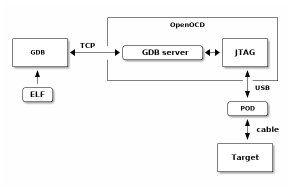

OpenOCD is a JTAG debugging package that interfaces to a wide of JTAG pods. JTAG is a low level high speed serial interface modern processors provide as a means of controlling the core processing logic. The features available depend on the architecture and processor. Typical functions include:
- Processor control and register access
- System level register access to allow SOC initialization
- General address space access
- Cache and MMU control
- Break and watch points
