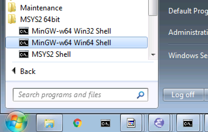

Open a 64bit MSYS shell from the Start Menu:
MSYS2 64bit Shell Start Menu
